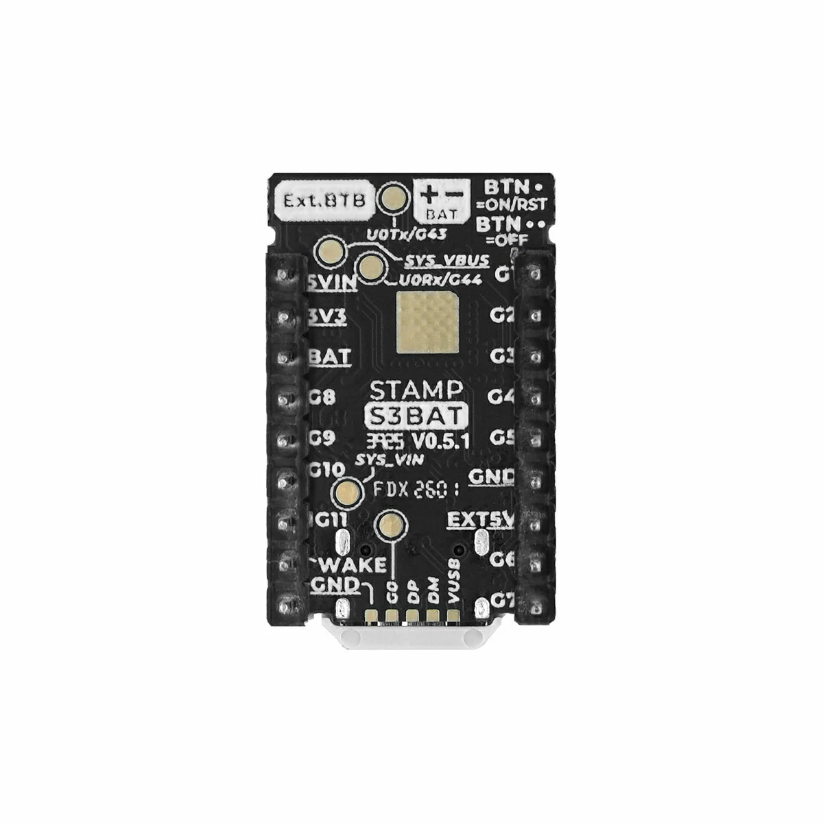

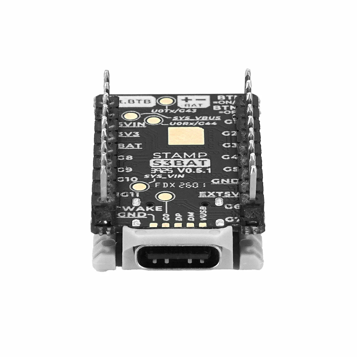

Stamp-S3Bat DIP is an embedded core module with integrated power management. It features the ESP32-S3-PICO-1-N8R8 main controller, supporting 2.4GHz Wi-Fi with built-in 8MB Flash and 8MB PSRAM. The module leads out 11 GPIOs and 1 wake-up IO, equipped with a 24P BTB connector (supporting DVP interface). An onboard battery power interface is provided for connecting an external 3.7V lithium battery. It integrates the M5MP1 multi-stage power control design, supporting power input/output control, lithium battery charging control, and status detection for input voltage and battery voltage. It also supports external low-power wake-up; after the main controller enters low-power sleep mode, the power can be woken up via the external wake-up IO. Featuring a programmable RGB LED, the Stamp-S3Bat DIP version comes with pre-soldered 2.54mm standard pitch headers, allowing integration into applications via PCB insertion, breadboard connection, or Dupont cables to help developers quickly build IoT applications.

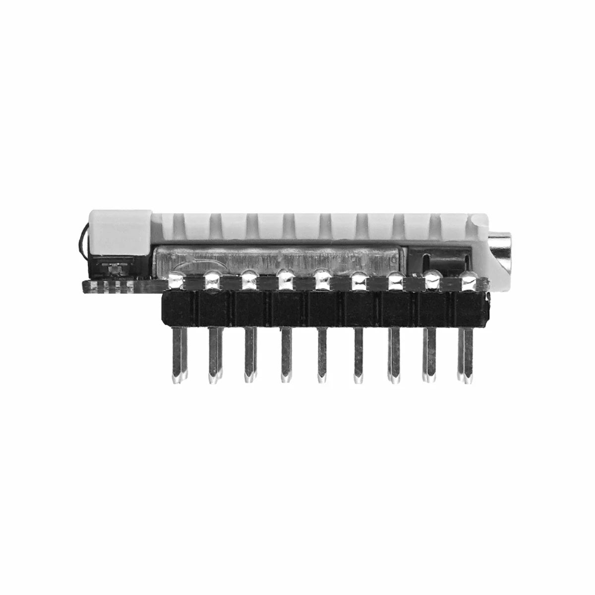

  • 2.54mm standard pitch headers

Pad GPIO Leads 11x GPIO (G1/G2/G3/G4/G5/G6/G7/G8/G9/G10/G11) + 1x Wake-up IO (PY_G4_WAKE)
BTB Interface GPIO Leads 19x GPIO (G40/G38/G12/G13/G14/G15/G16/G18/G21/G46/G45/G41/G43/G42/G39/G17/G44/G47/G48)

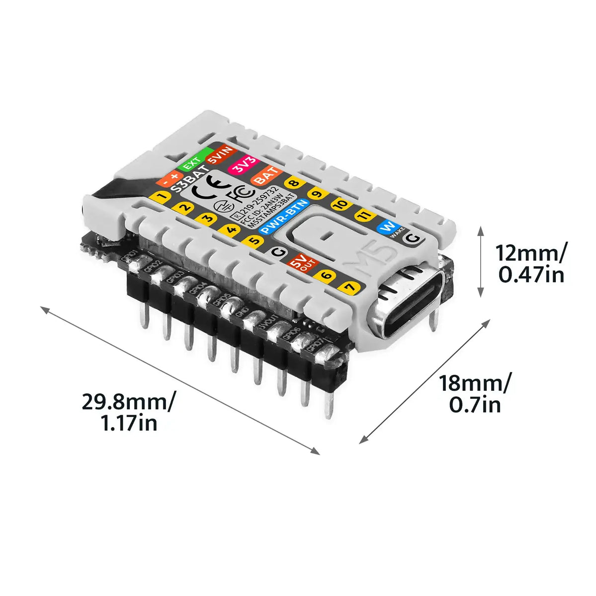

Product Size 29.8 x 18.0 x 12.0mm
