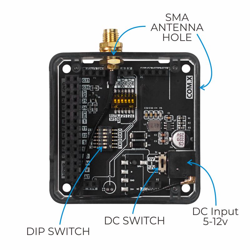

Module COMX LoRaWAN868 is a LoRaWAN communication module in the M5Stack stackable module series, supporting node-to-node or LoRaWAN communication. The LoRaWAN module is based on the ASR6501 design, encapsulating the PSoC4000 and SX1262 chips, and supports the 868MHz frequency band. It is designed with ultra-low power consumption, with extremely low current consumption (3.5μA) in deep sleep mode. To facilitate user configuration of pins, a DIP switch is used to set the hardware serial port pins. Users only need to switch the corresponding pins to ON as needed and specify the pins in the program. A DC power socket is designed at the bottom of the module, allowing power supply through an external power source. When paired with an external antenna, it can achieve better signal quality. This module is particularly suitable for remote low-power transmission applications where ultra-low power consumption and ultra-small size are core requirements. LoRaWAN is a communication protocol and system architecture based on the LoRa long-distance communication network. In terms of protocol layering, LoRaWAN is the Media Access Control (MAC) layer, and LoRa is the physical layer. It is a routing protocol maintained by the LoRa Alliance, primarily used as a network protocol for managing communication between LPWAN gateways and end-node devices.
Compatibility When used with the Fire main control, due to PSRAM pin (G16/G17) conflicts, please switch the module base DIP switch pins to TX(G0/G13), RX(G5/G15) when using.
