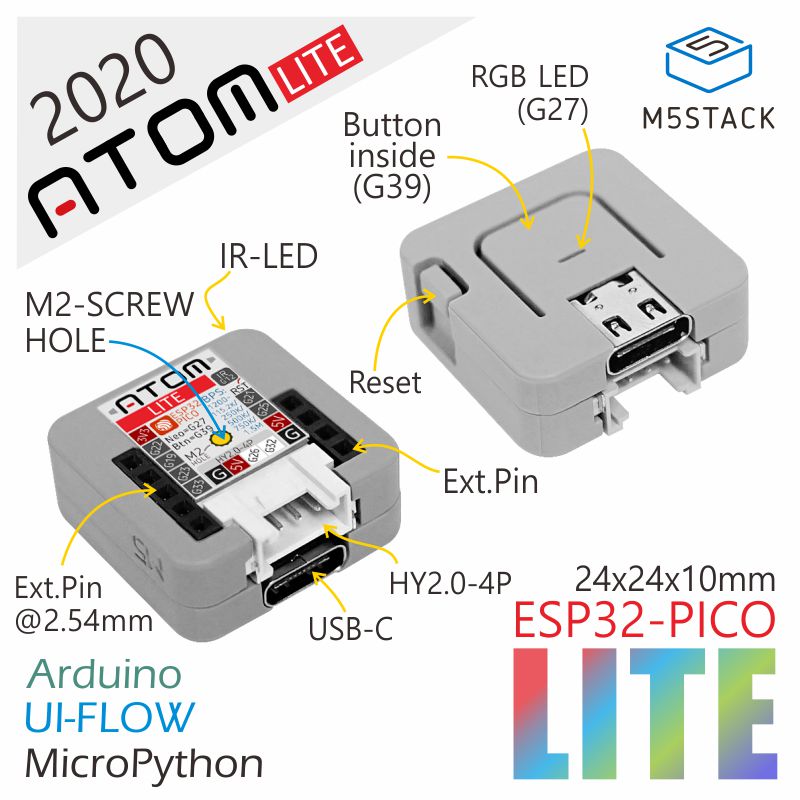

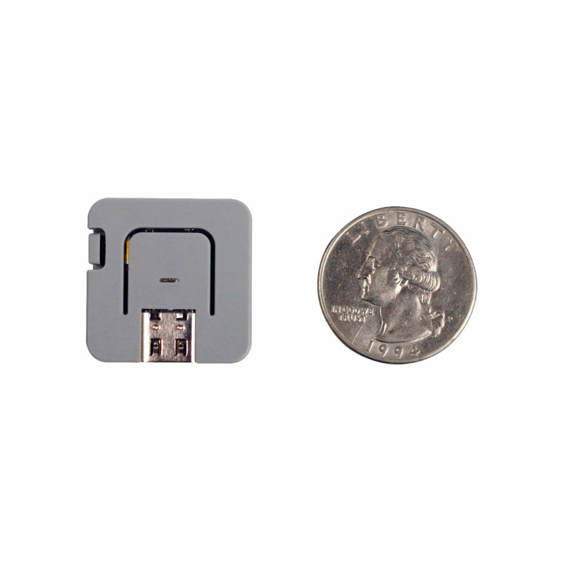

Atom-Lite is a very compact development board in the M5Stack development kit series, with a size of only 24.0 x 24.0 mm, providing more GPIO for user customization, making it very suitable for embedded smart hardware development. The main controller uses the ESP32-PICO-D4 solution, integrates a Wi-Fi module, has a built-in 3D antenna, and features 4 MB of SPI flash, providing Infra-Red, RGB Led, button, and GROVE/HY2.0 interfaces. The onboard USB Type-C interface allows for quick program upload and download, and there is an M2 screw hole on the back for fixing.
  • Based on ESP32 development
  • Compact body
  • Built-in infrared transmission function
  • Programmable button
  • RGB LED indicator

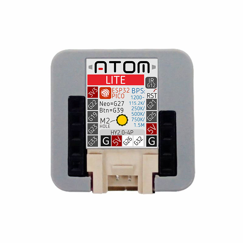

SoC ESP32-PICO-D4@Dual-core processor, 240MHz
DMIPS 600
SRAM 520KB
Flash 4MB
Input Voltage 5V @ 500mA
Host Interface USB Type-C x 1, GROVE(I2C+I/O+UART) x 1
PIN Interface G19, G21, G22, G23, G25, G33
RGB LED SK6812 3535 x 1
IR IR transmitter
Button Customizable button x 1
Antenna 2.4G 3D antenna

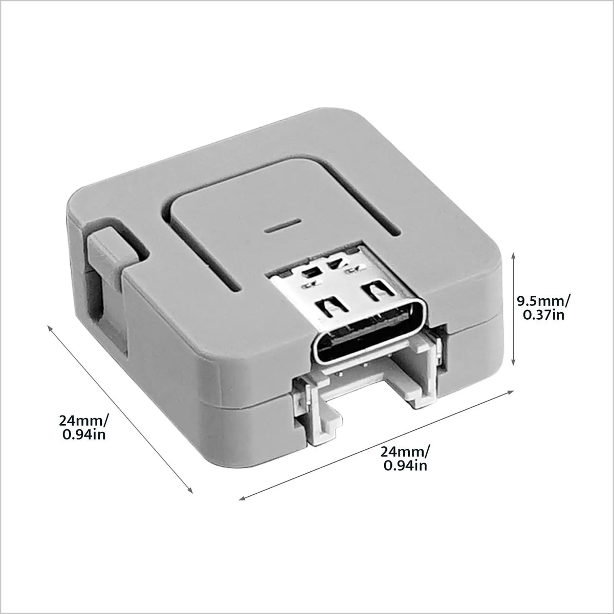

Product Size 24.0 x 24.0 x 9.5mm
